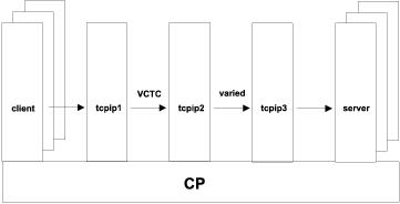

An internal tool was used to drive request-response (RR), connect-request-response (CRR) and streaming (S) workloads. The RR workload consisted of the client sending 200 bytes to the server and the server responding with 1000 bytes. The CRR workload had the client connecting, sending 64 bytes to the server, the server responding with 8K and the client then disconnecting. The streaming workload consisted of the client sending 20 bytes to the server and the server responding with 20MB.
Each workload was run using HiperSockets, Guest LAN (HiperSockets virtualization), QDIO, CLAW and VCTC connectivity with different MTU sizes. For HiperSockets and Guest LAN, 56K and 1500 were chosen for the streaming workloads, 1500 for CRR workloads and for RR workloads. For QDIO, 8992 and 1500 were chosen for streaming workloads, and 1500 for CRR and RR workloads. For CLAW and VCTC, 2000 and 1500 respectively were used for all workloads. All measurements included 1, 5 and 10 client-server pairs.
The measurements were done on a 2064-109 in an LPAR with 2 dedicated processors. The LPAR had 1GB central storage and 2GB expanded storage. CP monitor data were captured during the measurement run and reduced using VMPRF.

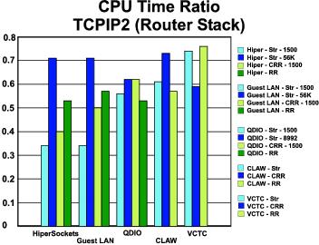

The following charts show the comparison between results on TCP/IP 420 and the enhancements on TCP/IP 430. The charts show the ratio between the two releases for router stack (TCPIP2) CPU time, server stack (TCPIP3) CPU time, and throughput. For all these charts, a ratio of 1 signifies equivalence between the two releases. The charts show the ratios for the 10 client case, but the ratios for 1 and 5 clients are similar. Specific details are mentioned, as appropriate, after the charts.
Figure 2. Router Stack CPU Time Ratios - 10 clients
The shorter the bar, the larger the gain in efficiency for the router. Larger gains were seen for both HiperSockets and Guest LAN when the MTU size was 1500. With the larger MTU size it makes sense that the benefit would be less since larger packets mean we cross the device driver interface fewer times for the same amount of data. All connectivity types gained for all workloads.

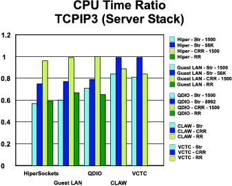

Figure 3. Server Stack CPU Time Ratios - 10 clients
The server stack shows the same trend as the router stack by gaining the most with HiperSockets and Guest LAN when the MTU size is 1500. The CRR workload showed the smallest improvement for this stack. The gains, in this case, are not as great because the base costs are higher due to the overhead of managing connect-disconnect.

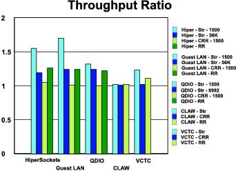

Figure 4. Throughput Ratios - 10 clients
For this chart, the taller the bar the better. Both HiperSockets and Guest LAN with MTU size of 1500 showed the greatest increase while CRR again shows a small improvement. By looking at the tables later in this section, we can see that the server stack (tcpip3) is the bottleneck, using more than 90% of one CPU.

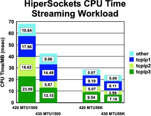

Figure 5. CPU msec/MB Streaming with HiperSockets
This chart, and the next one, show a comparison for CPU usage for the whole system. These are a sample of the data collected. For full data refer to the tables that follow. In these charts the stacks are broken out with the category "other" including the client and server workload tool.
Since one of the drivers targeted for improvement was VCTC, and TCPIP1 communicated with the router stack using VCTC, an improvement is seen for this stack as well.

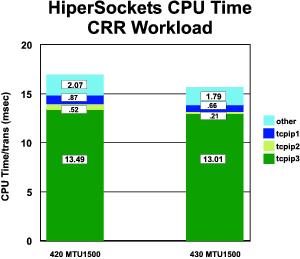

Figure 6. CPU msec/trans CRR with HiperSockets
This one is interesting as it shows that the Server stack has very high CPU Time as compared to the other stacks and to "other".
